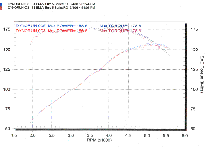

Postby Peter Florance » Thu Mar 16, 2006 3:54 am
The second RPM number is where your motor will most likely need the greatest amount of AE in terms of total ms and percent on the AE Driven Fuel Percent gauge.
Great writeup Andy. Any idea where this might occur? Peak torque point? Or before it, as sort of a feed-forward type of thing? Of course mine was so flat on the dyno Saturday, I might need a carpenter's level to find it. (note to self: get bigger exhaust)
If you're going to go into details of map-dot, you might get Mike Robert's input. I had a very illuminating conversation with him when we were hanging out in Holiday Inn lobby. Unfortunately I need to ping on him again as the holes in my sieve-like brain are getting larger and I've lost some of the tuning details. :x

Postby whittlebeast » Thu Mar 16, 2006 5:03 am
Pete
Remember the two most dominent things on a warmed up motor is changing RPM and changing MAP. The MAP changes huge at 1000 - 2500 when driving in traffic. Just watch the gauge. Then look at the PW1 gauge and at least with my motor at idle the pw1 is in the 2 ms range but at 2500 it is fairly easy to require 3 ms of pw1. Fuel flow is (pw1-opening time) * MAP/100 * VE/100 * RPM * (other less dynamic stuff)

What would be neat would to be able to 'weight' the AE by map. If I'm in a low gear at 5500 rpm I'll have a lot less load then if I'm in 4th gear at same rpm (friction of pushing barn-door shaped sedan at 100mph)
But as you say, RPM-based AE is trying to do a lot without a lot of processing and it appears to do a fine job of it.
